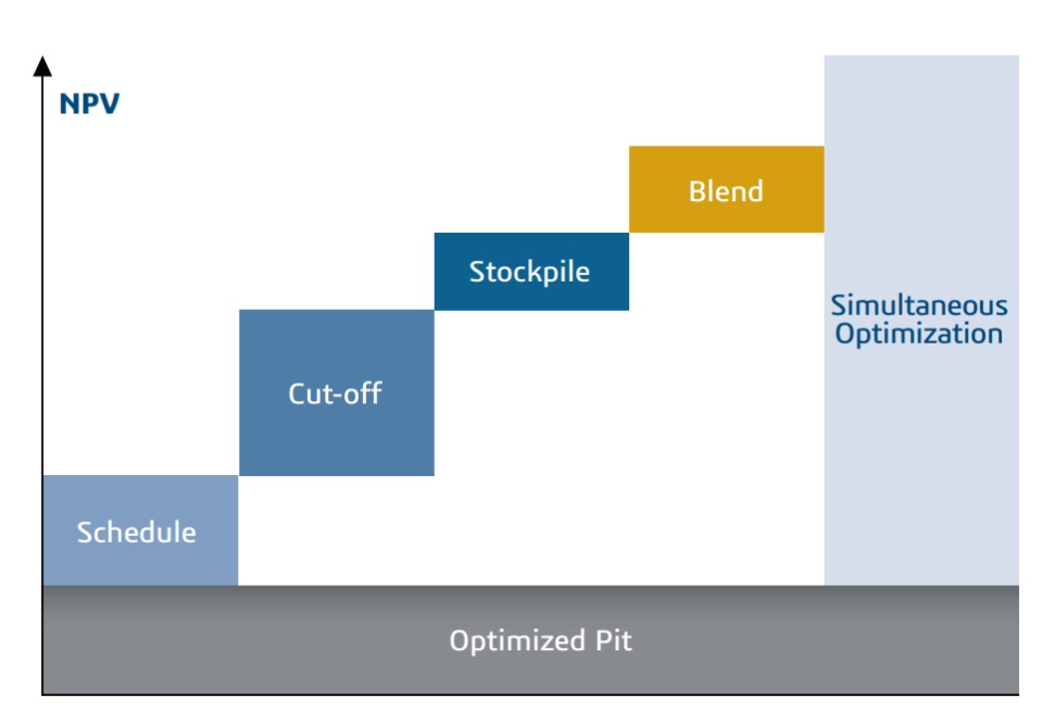

The basic assumption made when optimizing one parameter separately from others is that the parameters are independent of each other. For instance, cut-off optimization assumes that the cut-off grades can be optimized independently of the schedule. However, changing the cut-off often means that the schedule that was once optimal may not be optimal for a different cut-off. When optimizing in separate steps, a decision made at an early stage (e.g., Schedule in Figure 1) impacts later decisions, hence reducing or masking possibilities of a better solution altogether. The following sections, Steps 1 through 3, will briefly describe the logic in deriving an optimal mining schedule with SIMO.
Fig. 1: Gain in NPV using incremental method compared to gain in NPV with Simultaneous Optimization. Schedule, Cut-Off, Stockpile and Blend optimization provide Cut-off incrementally lower NPV.
