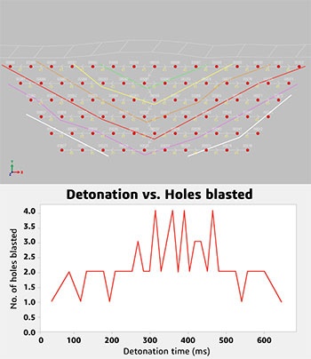

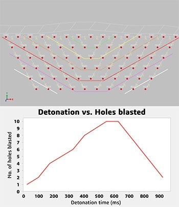

V-Shape and Zigzag / row by row firing sequence
If the blasts have only one free face, the optimal firing sequence is usually V-shaped (Figure 1). The expected movement will be in the direction of the free face with a shallow V and the movement is uniform throughout. The throughout angle can be determined by the surface delay and the position of the initiation point. The expected surface profile will be flat. This firing sequence with a flat V angle allows for easy movement control, resulting in less ore loss and dilution regardless of monitoring.
Figure 1. V-Shape firing sequence with one free face.
Figure 1 also shows the number of blasted holes during the blasting time in milliseconds. The number of holes blasted at the same time (instantaneous maximum charge) increases gradually up to a certain point and then decreases again, which can lead to ground vibrations.
The expected outcome from a zigzag/row by row firing sequence will be the same as V-shape (Figure 2). The main differences are that zigzag firing sequence is much easier to apply in the field and the throughout will be less than the V-shape firing sequence. Furthermore, the number of holes blasted at the same time will be less than V-shape.
Figure 2. Zigzag firing sequence with one free face.

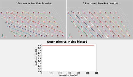

Echelon firing sequence
If a blast has two free faces, the suggested firing sequence configuration is the echelon, as shown in Figures 3. The figures show how the direction of movement can be varied by changing the timing of the control and echelon rows. The initiation point is at the corner of the two free faces.
Figure 3. Echelon firing sequence 25 ms control line.
The pattern minimises the possibility of tight toe problems, and it is easier to connect up as the paths can be easily monitored. The expected movement will be uniform in a given direction with a shallow angle (180°). The direction of movement can be controlled by a suitable surface delay.
An effective echelon firing sequence increases the percentage of the rocks that move consistently. The main reason for the consistent movement is that the intervals between timing contours are consistent, resulting in a uniform movement. With a right pattern size and surface delay the number of blasted holes at the same time will be uniform during blasting, resulting in less ground vibration.

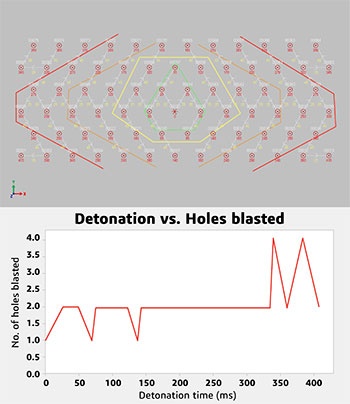

Box cut and centre lift
Box cut and centre lift is recommended when blasting has no free face. For deeper blasts, coupling with the centre lift is preferred. For shallower blasts, especially ramps, the box cut firing sequence is recommended (bearing in mind that the initiation point should be at the deepest point of the ramp to allow adequate movement).
The central lift (Figure 4) consists essentially of four echelons. Each sub-echelon is smaller, so the movement does not take as long to settle down to ‘normal’. Also, the number of mid-echelons and power troughs doubles compared to the previous firing sequences. The number of holes blasted simultaneously depends on the length of the branch, with the possibility of stemming ejection due to confinement movement.
Figure 4. Centre Lift firing sequence 25 ms control line.

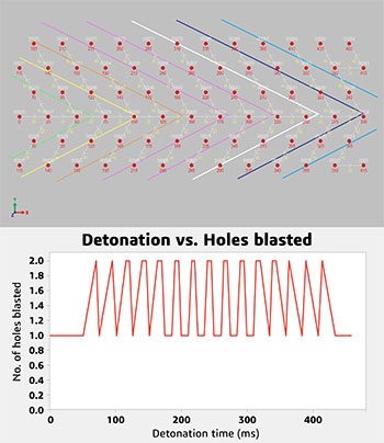

The box cut consists of a single control line in the centre of the shot with two branches radiating from the control line (Figure 5). The number of holes blasted can be consistent if the two branches are the same length.
Figure 5. Box Cut firing sequence 25 ms control line.
