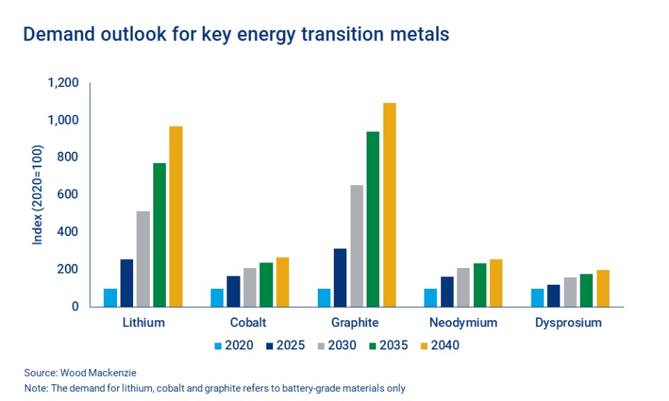

This is a time of unprecedented opportunity for energy transition metals. Lithium, cobalt, graphite and rare earths are crucial building blocks of a decarbonised world – but to move towards a truly sustainable future these sectors must tackle a significant environmental, social and governance (ESG) challenge.
The central dilemma is clear. Can vital energy transition metals markets ramp up production fast enough to satisfy demand, while also revolutionising supply chains to meet ever-more stringent ESG requirements?

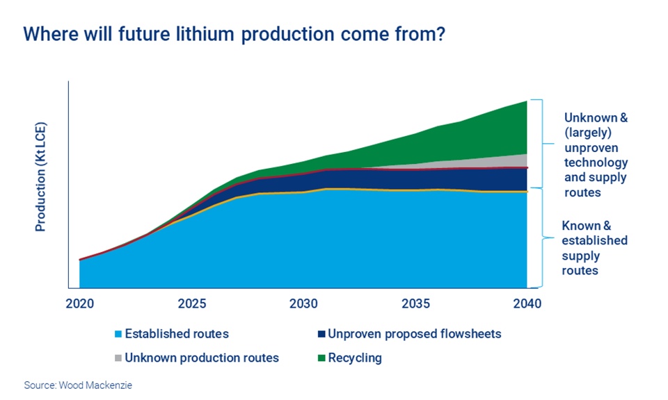

Lithium: high water consumption versus high carbon emissions?
The lithium sector faces a binary problem. Buyers – auto manufacturers, cathode manufacturers and other OEMs – must choose between two routes: brine or mineral sources. Each involves a distinct ESG challenge, centred on either water consumption or carbon emissions.
Brine sources:
Concerns over high water consumption at lithium brine operations have led to conflicts with local and state authorities in South America, and investigations into the efficacy of production. Plus, brine producers not only have greater water consumption rates than mineral concentrate producers, but they’re operating in some of the driest places on earth, with high levels of water risk.
Mineral sources:
Most lithium mineral concentrate is shipped to Chinese refineries reliant on coal power. In terms of embedded emissions per tonne of refined lithium produced, this refining stage contributes 70-90% of all carbon emissions within the mineral concentrate supply route. This doubling up effect, of high energy consumption and high emission fuel use within the mineral supply chain, makes refined lithium produced via mineral concentrate 3.5 times more CO2 intense than brine.
This creates a downstream dilemma. High embedded emissions within a value chain are a clear carbon risk. However, issues associated with high water consumption could hamper expansion plans and limit capacity.
Over the coming decades, a growing proportion of refined lithium production is likely to come from unproven routes. This includes projects aiming to use direct lithium extraction (DLE) technology and extract from unconventional mineral deposits, such as clay, sedimentary or borosilicate minerals.
These routes have potential, but there are engineering challenges. There are no successful commercial-scale lithium production routes using unconventional mineral deposits as feedstock, and limited examples of DLE technology being successfully employed at commercial scale,or achieving the necessary quality of refined lithium.

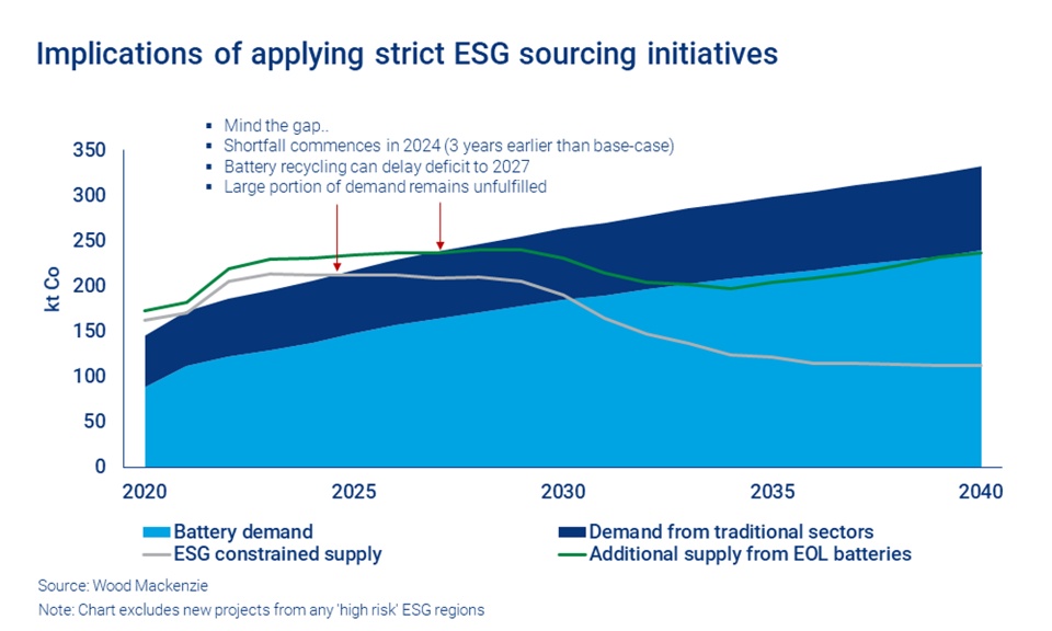

Cobalt: ESG adds to the rising cost challenge
The cobalt market is forecast to double in size by 2050, underpinned by a spectrum of battery applications. But a significant supply gap lies ahead, requiring further expansions at existing mining operations and new investment.
There are several sizable obstacles. The cost of mining cobalt is on the rise, due to ore grade attrition and reserve depletion. Surging metal prices and strong EV momentum are triggering a revival of resource nationalism in key producing countries, posing a risk of supply disruption. ESG risk heightens the challenge.
Cobalt reserves and mine production are concentrated in regions and countries that exhibit significant ESG risks. The DRC and Indonesia, by far the top two cobalt reserve holders, are both categorised as high-ESG-risk countries in Verisk Maplecroft’s ESG Risk Index.
In an ‘ESG constrained supply’ scenario, a shortfall in the cobalt market can emerge as early as 2024. Battery recycling, if fully utilised, can ease the upcoming supply shortage, but it cannot fill the entire gap. This implies that virgin cobalt materials will remain critical to meet the surging demand.
To build up a more resilient supply chain, the industry must take action to address ESG issues through continuous innovation and collaboration. Advanced mining technologies can help improve mining practices, reduce costs and increase traceability of materials. For regions with limited cobalt reserves, such as Europe and North America, or for high-cost producers like Australia, government backing will be crucial to establish localised value chains. Alternative feedstock options must also be explored to mitigate the risk of supply disruption.
Rare earths: a crackdown has seen a fall in illegal and unregulated production – but challenges remain
Growth in rare earth permanent magnet demand is set to increase by 89% by 2030, primarily from automotive and renewable energy applications. China currently dominates the industry and is forecast to account for 63% of total rare earth mine production and 84% of refined output in 2022 – and more than 95% of recycled production. With supply tight, industry and governments in the rest of the world are looking to reduce dependence on China, though commissioning at many projects under development remains unlikely in the short to medium term.
The environmental impact of rare earth mining and processing has been well documented, with production from ionic adsorption clay (IAC)-type deposits a particular issue. Deposits largely occur in remote regions, spread over large areas, making inspection and monitoring challenging. A crackdown by state governments, coupled with falling rare earth prices, did result in a sharp drop in illegal and unregulated production of rare earths from IAC-type deposits in China in 2021. This is progress, but it doesn’t resolve the issue – the crackdown has sparked the development of IAC deposits in Myanmar, and more recently in Laos.
ESG challenges related to IAC-type deposits are a key issue going forward, and innovative solutions must be found. Other methods have been trialled, though have to date proven unsuccessful alternatives to the ammonium-sulphate in-situ leaching widely used in southern China and Myanmar.
The importance of IAC-type deposits is focused on the production of the less abundant heavy rare earth elements. In 2022, such operations will provide 70% of dysprosium oxide mine supply – limited development of IAC-type deposits in the period to 2030, fuelled in good part by ESG concerns, will see this fall to 53%. As a result, other rare earth operations with much lower heavy rare earth contents will have to meet demand growth, particularly for dysprosium and terbium, in permanent magnet applications.
