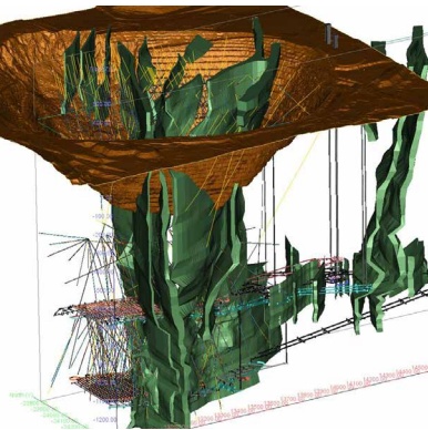

A 3D view of Palabora’s open pit and two block caves.

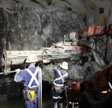

Underground production at Palabora’s mine.
