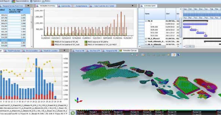

Efficient production scheduling

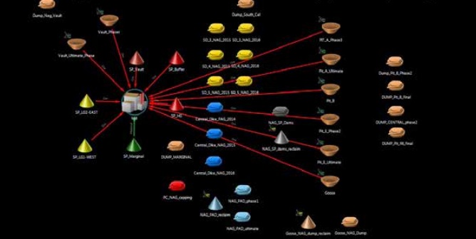

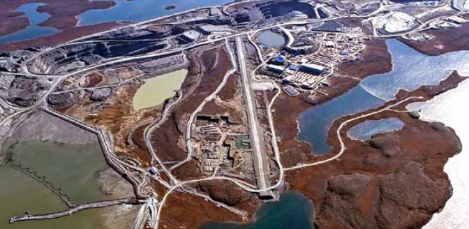

Meadowbank is one of the most complicated waste management sites in Canada with 14 dikes, 9 pits, multiple dumps and more than 100 haul routes – all of which are digitized and scheduled in MineSched.
Having a dedicated GEOVIA staff member onsite was excellent. He provided technical support which advanced our operations. Working together, we surpassed last year’s production targets. - Stephane Frechette, Engineering Assistant Superintendent
To increase operational efficiencies and reduce costs, Meadowbank modeled their entire material handling plan in a MineSched schedule. They now track how much construction and reclamation material is needed, whether they have enough material available, and when they have the capacity to move it. Thanks to accurate planning and forecasting, Meadowbank eliminated four contractor trucks from their hauling fleet, resulting in significant operational savings. Using MineSched, Meadowbank determined that they could both feed the mill and meet, or even exceed, their production schedule targets without those four trucks.
“With MineSched, we’re much more accurate in our planning and evaluation of truck hours. We’re saving on contractor costs, because this tool helps us to accurately evaluate new projects,” says Ramsay.
Previously, Meadowbank had two low grade stockpiles that occupied key locations around the site. Once the stockpiles were processed, the Engineering team was able to quickly design new waste dumps, which were configured for capacity and operational efficiency. As a result, they now include more short-haul in their waste management plan, which increased mining capacity by focusing on the high grade areas.
Meadowbank has tracked the entire mine closure plan, as well as the life of mine operational plan, in one system. They now have peace of mind that they have the haulage and the mining capacity to maintain the production numbers, while also following through with their mine closure plan.
“MineSched is an amazing tool – if you don’t manage your time and schedule effectively, you won’t be able to meet your mine objectives. Managing all of this in a spreadsheet would be impossible,” says Frechette.
