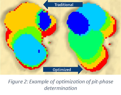

After knowing the best starting point based on the strategic objectives, this exercise will respect several operational restrictions that will reduce the impact of the operational mining design on the VPN obtained from the optimal phases (pit-shells), minimizing the loss of value. (Fig. 2).

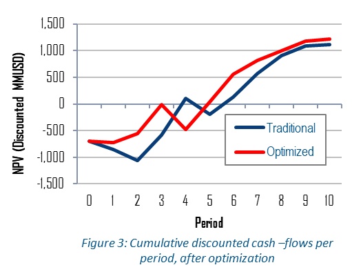

Main benefits obtained by applying this methodology consist of a better performance of the production plan, particularly in the improvement of average grades to process plant, which ultimately results in greater metal content production at the initial periods of the plan, ensuring an early return on investment and a project value improvement. (Fig. 3).
