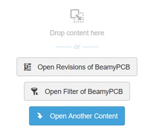

  1. Search objects from Compare home page
    You can open content for compare by searching for the object in 3DSearch, and load it in Compare.

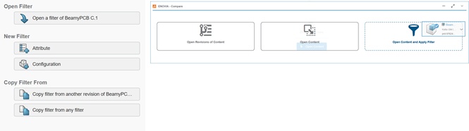

  2. Drag objects from another app or the search results
    You can select the object to compare either from another app or search results. Than drag the desired object into Compare, in one of the following sections
    1. Open Content: Loads the object you selected (same as before)
    2. Open Revisions of Content: Lets you select another revision or duplicate of the object in the Revision Explorer.
    3. Open Content and Apply Filter: Lets you select or create a filter of the object. You can open a saved filter, create a new filter, or copy a filter from an existing one.

Select the data to compare with (in the right side of Compare app)
Then, you can select the data you wish to compare with. It can be an existing revision or duplication of the loaded data, existing or new filter applied on the loaded data, or any other data you search and select from 3DSearch or other application.

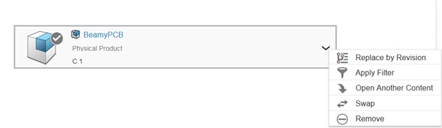

Several actions are available on the loaded objects on either side before running compare
When objects are already loaded in Compare, you can easily change it before performing another compare without the need to clean all and start from scratch. You can replace by revision or duplicate, apply a filter or even replace by another content from 3DSearch.

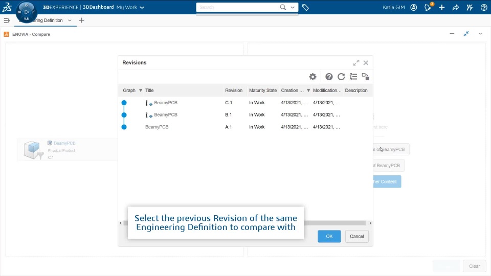

The attached video illustrates a sample use case of comparing different revisions of the same filtered product structure:
