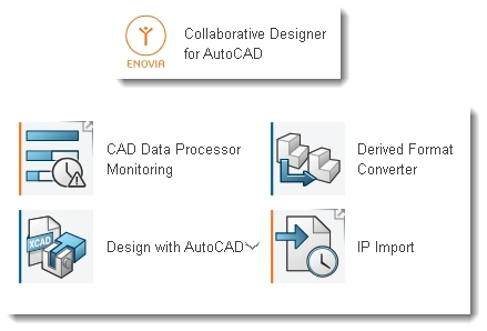

The IP Import application is bundled with the following roles:
- 3D Product Architect (PAU)
- 3DEXPERIENCE Transition Assistant (3DXTA)
- Collaborative Data Integrator for IFC (IFC)
- Collaborative Design for CATIA V5 (UE5)
- Collaborative Designer for Revit (UDV)
- Collaborative Designer for AutoCAD (UDA)
Here is an example of the role “Collaborative Designer for AutoCAD” that contains this app:

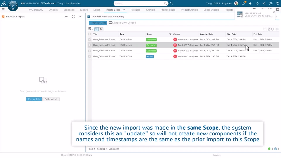

When working with CAD data, the IP Import app works closely with the “CAD Data Processor Monitoring” application. This app lets you monitor the status and results of import jobs executed by the IP Import app. One important value of this application is that it allows you to import CAD data without using the CAD integration tools, and the associated engineering and design staff, in import scenarios. Subsequently import interactions can be handled by non-engineering staff.

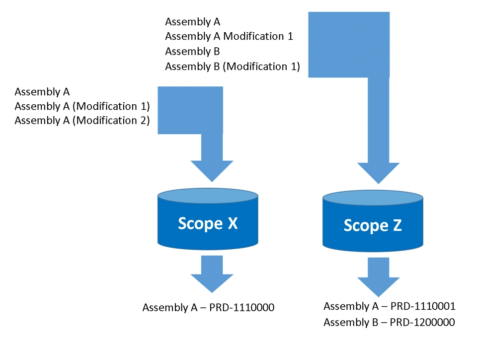

Another important feature of the IP Import application is it’s ability to import the the same data multiple times and not create duplicate data. This is controlled through the concept of “Scope”. Scope represents a context with which product structure data is saved to 3DEXPERIENCE platform. You can create data in a particular Scope where each CAD design is unique. You can continue to update data in the same mode. The same data can be saved as a new copy in another save scope and be updated independently and continuously. This provides a great amount of control of imported data as designs evolve across multiple imports of the same data.
In the example illustrated below, two unique assemblies are imported into the platform in the context of different saved scopes resulting in three unique product structures. This is an important capability when working with imported data that has previously been imported, as such data cannot be overwritten and may require subsequent imports of the same data into a new saved scope.

The following video shows an example of importing NX data with subsequent modifications. In this scenario we will explore the import of multiple CAD datasets (NX format) in a common Scope as well as different Scopes.
With the release of 25xGA, IP Import of CAD data supports incremental loading in CATIA V5 and NX but will be expanded over time to the other managed CAD solutions.
