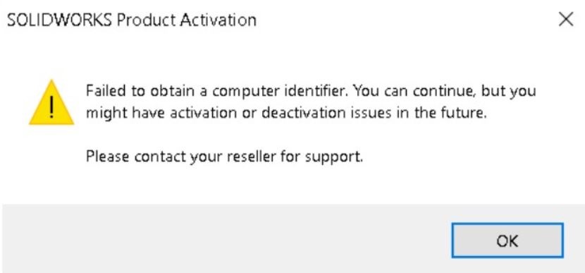

When I try to start the DraftSight® stand-alone application, why do I see the error ‘Failed to obtain computer identifier…’?
This error can occur if the 'FlexNet Licensing Service' is not running on the system. See the attached image.
For the DraftSight® stand-alone license to work correctly, a few services must be running on computer.
To resolve this issue, follow these steps:
1. Open the Windows® ‘Services’ app.
2. Locate the ‘FlexNet Licensing Service 64’ service.
3. Change the ‘Startup type’ to ‘Automatic’.
4. Start the service.
