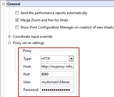

With DraftSight version , V1R3.1, a discrepancy has been reported with proxy server settings not being remembered when stored from the Options menu.  Although this has been resolved in the next release of DraftSight V1R4 (scheduled for release early April), use the instructions below as a workaround to set your proxy server settings.

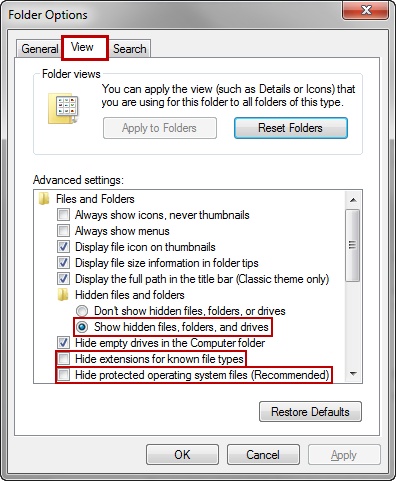

  2. You will need to show hidden files and folders as well as enable file extensions for known file types.  To display hidden files and folders as well as to enable file extensions:

For Windows Vista / 7 / 8:
Open Folder Options in Control Panel
  1. Click Start, and then search Folder Options
  2. Select Folder Options from the list
  3. Click the View tab
  4. Under Hidden files and folders, click Show hidden files and folders.
  5. Scroll down in the Advanced settings list and uncheck Hide extensions for known file types and Hide protected operating system files (Recommended)

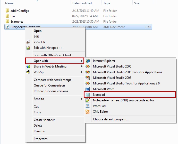

  3. Right-mouse click on ProxyServerConfig.xml and select Open with > Notepad as shown below

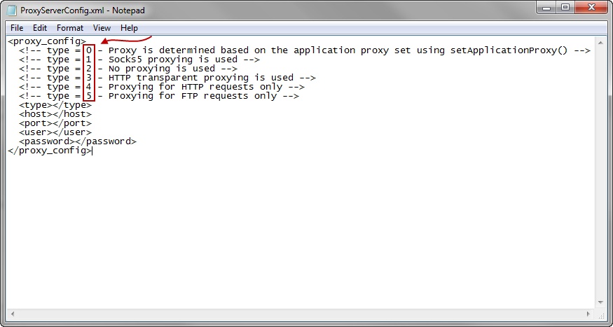

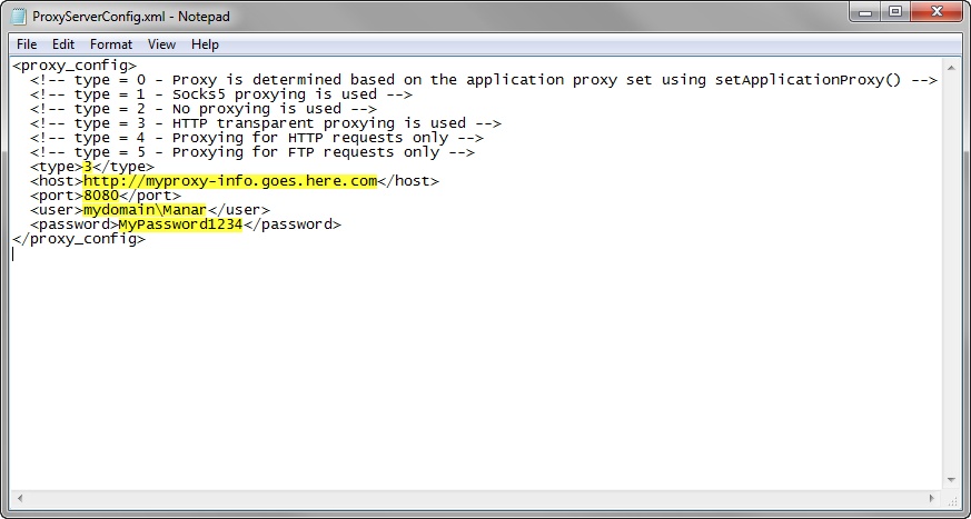

  4. There are six proxy configuration types listed at the top.  Identify which number corresponds to your proxy type, and then write this number between and .  For example, if an “HTTP transparent proxying is used”, input a “3” in between the text and .  Fill in the rest of your proxy settings as demonstrated.  The before and after screenshots below will help guide you with this:
    Before                                                                            After
  5. When complete, go to File > Save
  6. Your proxy settings should now be stored in DraftSight options allowing you to activate DraftSight.
