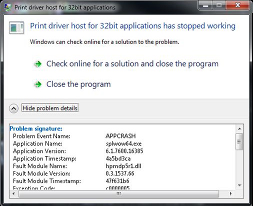

This guide will provide a workaround to help resolve most cases of printing issues related to the error message, “Print driver host for 32bit applications has stopped working…”, as well as help resolve most cases of slow appearing print dialog boxes.

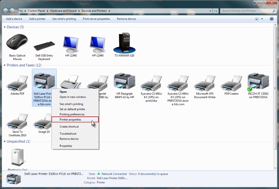

1. Click on the Windows Start logo > Devices and Printers
- OR -
Control Panel > Hardware and Sound > Devices and Printers
2. Right-mouse click on the printer experiencing the issue and select Printer properties as shown below.
Figure 1 Screenshot of Devices and Printers window located in Control Panel

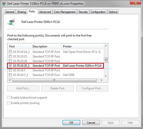

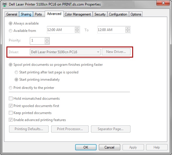

3. When the printer properties dialog window appears, make note of the following information (see below for detailed screenshots):
- Printer name and model number (See screenshot 2a)
- TCP/IP Port number and print server name (See screenshot 2b)
- Current driver version (See screenshot 2c)

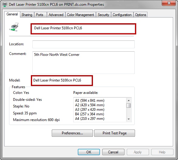

Figure 2a Screenshot of printer properties General tab
Figure 2b Screenshot of printer properties Ports tab

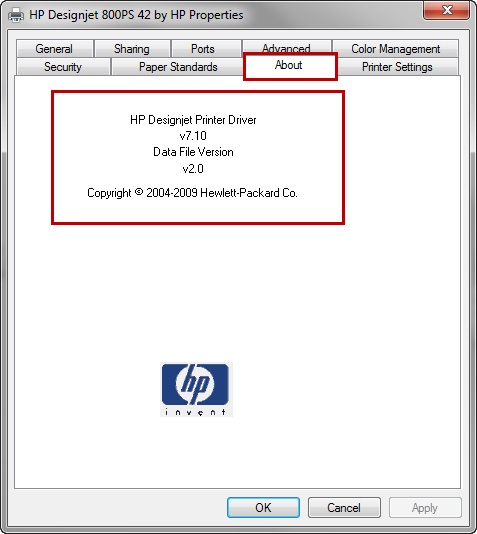

Figure 2c Screenshot of printer properties Advanced tab or About tab (Please note not all printer properties have an About tab)

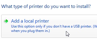

6. Reinstall the printer as a locally attached network printer. To do this, click the Add a printer button in the Devices and Printers window from the previous step.
7. In the resulting window, select Add a local printer.

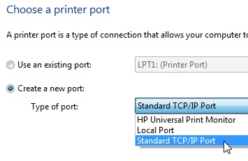

8. Select the option to Create a new port and select Standard TCP/IP Port from the dropdown menu.

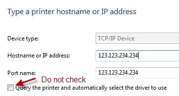

9. Type in the networked printer’s hostname or IP address. The port name will automatically fill itself in with the same information. Be sure to leave the Query the printer and automatically select the driver to use box unchecked, then click Next.

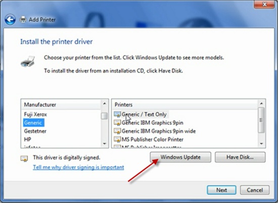

10. Click the Windows Update button to retrieve an updated list of printer drivers from Microsoft, and then locate your printer in this list to proceed with the installation.
Alternatively, select Have Disk… and point to the printer drivers obtained from step 4.
