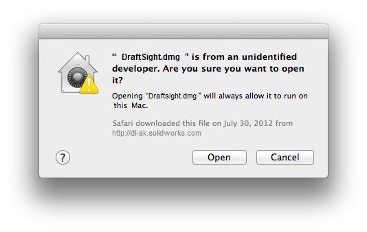

Mac Users might come across this message or a very similar "This App can't be opened because it was not downloaded from the Mac App Store", when trying to install DraftSight.
This message, in fact, is not an error message, or even exclusive to DraftSight.
The message you obtain, is generated by a new Mac OS feature called Gatekeeper. This feature is intended to protect users from malicious software, by blocking the install, but can also affect any application that is not downloaded from the Mac App Store, as it is the case of DraftSight.

2 - Open the software and get the error message that your software "can't be opened because it is from an unidentified developer." Click OK.
3 - Try opening the software again but this time right click on the software. (You can right click on a Mac, by pressing ctrl and clicking simultaneously). Select open from the menu.
4 - You should now be given the option to open the software. Click "open".
