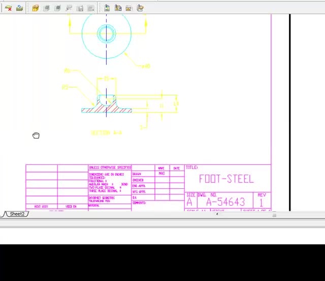

-          In a sheet, Zoom in to a Viewport (make sure is unlocked), enough so that you don’t see the Viewport lines (therefore you are unable to select them, or double-click outside to retur to the Sheet).
-          Double-click with your mouse. Welcome to Model Space. You are now able to create/modify geometry, the lot.
So you have done all that you wanted, created/modified geometry, etc.…. But how do you leave the floating Model Mode, and return to the sheet? If the Viewport lines were visible, double-click outside the Viewport would return you to the SheetMode. If the Viewport was locked, you would just need to Zoom out, just enough to allow you to double-click outside the Viewport, and return to the SheetMode. Undo the actions until it returns you to a state/view where you are outside the viewport, is out of the question (after all, you just spent xyz minutes drawing and making changes to your drawing!). You are stuck in a viewport….
Well, not exactly: When working on a sheet, the SheetMode/ModelMode command lets you toggle from Model workspace to Sheet workspace. If you are “stuck” in a viewport, unable to click outside a viewport, in order to return to the sheet, Type  SheetMode, and hit enter. This command will deactivate the Viewport and you are back in/SheetMode.
To switch to Model workspace, use the ModelMode command.
Take a look at the video below for a demo of the scenario mentioned above.
