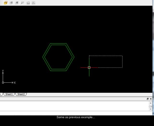

Check the video below, to see some applications.
ALIGN Command Demo
Note that the Align command aligns entities with respect to other entities or other target points on 2D planes, or in 3D space. So if you are working with a drawing in 3D, make sure you are selecting the correct points for reference. And speaking of 3D, a quick note on the variant ALIGN3D. The Align3D command aligns entities with respect to other entities or other target points in 3D space, and combines the Move and Rotate, or the Move and Rotate3D commands.
