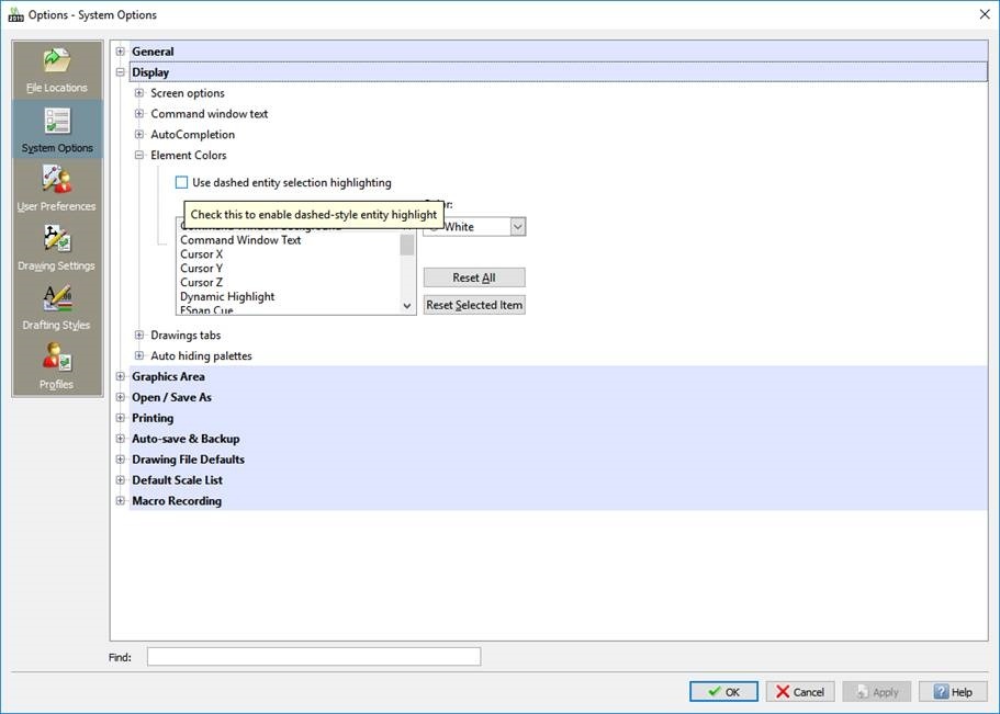

For users facing the issue in the current DraftSight version, the workaround below can be applied:
  • Go to Options/Type Options, Press Enter
  • Select System Options
  • Expand the node Display
  • Expand the node Element Colors, and enable ‘Use dashed entity selection highlighting’
  • Click Ok.
  • Restart DraftSight
