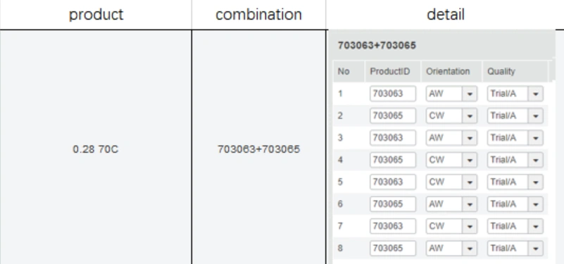

In the business scenario of work flow simulation, sometimes we need AGVs to pick up activities according to certain material combinations. For example, in the picture below, to produce a product like "0.28 70C", I need a combination of 4 "703063" and 4 "703065". So I need AGV to pick up the raw materials according to my combination. At this point, I need a feature called “chaotic storage”.

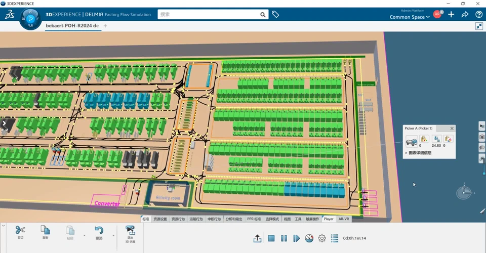

In the demo below, you can see that I edited the combination content through "Chaotic Storage" and had AGV pick up according to the combination

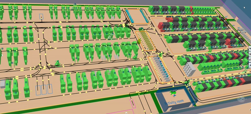

In fact, this is a requirement we encountered in a work flow simulation project at CHINA GEO. This project has just been delivered. Below are the simulation results of the project delivery. Of course, we have also provided layout optimization suggestions to the client based on the simulation results.
