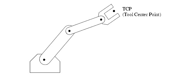

Tool Centre Point (TCP) - The tool centre point is located either on the robot, or the tool. Typically the TCP is used when referring to the robots position, as well as the focal point of the tool. (e.g. the TCP could be at the tip of a welding torch) The TCP can be specified in cartesian, cylindrical, spherical, etc. coordinates depending on the robot. As tools are changed we will often reprogram the robot for the TCP.

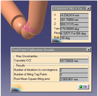

 Upon convergence, an analysis of the results is displayed:
  • Number of iterations: the number of iterations required by the numerical identification method.
  • Number of fitting points: the number of points used for the least squares fitting procedure.
  • Root mean square fitting error: the root mean square fitting error on the points after adjusting the Tool Profile to the best fit possible.
  • Max Uncertainties: the maximum of the uncertainties for the fit on the parameters to be identified. Large uncertainty values are an indication that the experimental observation strategy was flawed - even if the RMS fitting error was small.

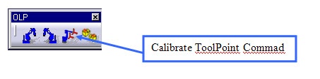

UI Buttons: The button for this command is in the OLP tool bar with command title “Calibrate ToolPoint”.

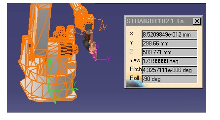

 2) Once the Resource has been selected, a dialog box showing the current TCP values is popped up.
The position of the TCP is shown by a magenta colored co-ordinate system as indicated in the image below.

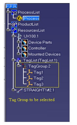

3) The user will then be prompted to select a Tag group which represent the simulation points that needs to be adjusted. This Tag group is assumed to have been generated at the Robot's mounting plate while moving the tool tip to a fixed point in space at different orientations of the Robot's wrist. The tag group can be selected either from the PPR tree as shown below or by directly picking any tag point.

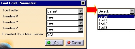

4) Once the tag group has been selected, a Dialog box will be displayed allowing user to input the following parameters:
Here user can pick the valid Tool Profile (Utool) for the selected Robot from the list. Then the Robot Tool Profile will be adjusted in an attempt to get the tool tip to move to the same point in space from different wrist orientations. Upon convergence, the following dialog box will be displayed showing an analysis of the results. The initial and calibrated positions of the TCP are also shown by two co-ordinate systems.
