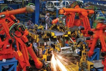

What is involved in each of the Spot welding Lines and Stations?
  • Each Spot welding Line consists of a number of Spot welding Stations and each Spot welding Station consists of a number of Robots ranging from 1 to 5 and activities in each Spot welding station can typically be as follows :
  • Material Handling by a robot  to Pick up the component and place on fixture
  • Pick up more components and place on fixture
  • Clamping of the components together to facilitate spot welding
  • Robots move in to Spot weld spots
  • Pick up the finished component and transfer it to the next Station and this could be either done by Material handling robots or by dedicated Transfer mechanisms
  • Sometimes, the same robot could be involved in Material Handling as well as Spot welding. In such cases, the robots will have both a GRIPPER and a Spot welding gun mounted at the TCP. In these cases, the TCP will have to be changed depending on the end effector to be used.
