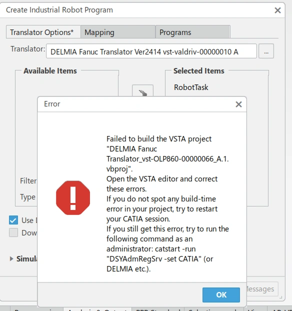

If you don’t already have the complete installation for one of these two compatible versions, you will probably get this issue when launching one of the OLP command:
In this situation, we can only recommend you to find a way to download Visual Studio 2017 or 2019.

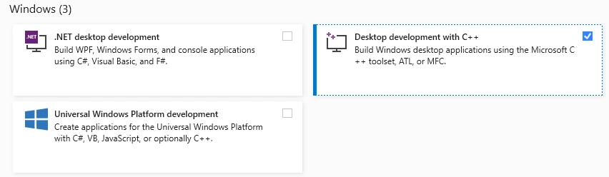

When the Installer is downloaded, launch it and install:
  • Desktop development with C++ (for the compiler).
    • Don't forget to install the C++/CLI Support for Build Tools
  • .NET desktop development (for OLP)
