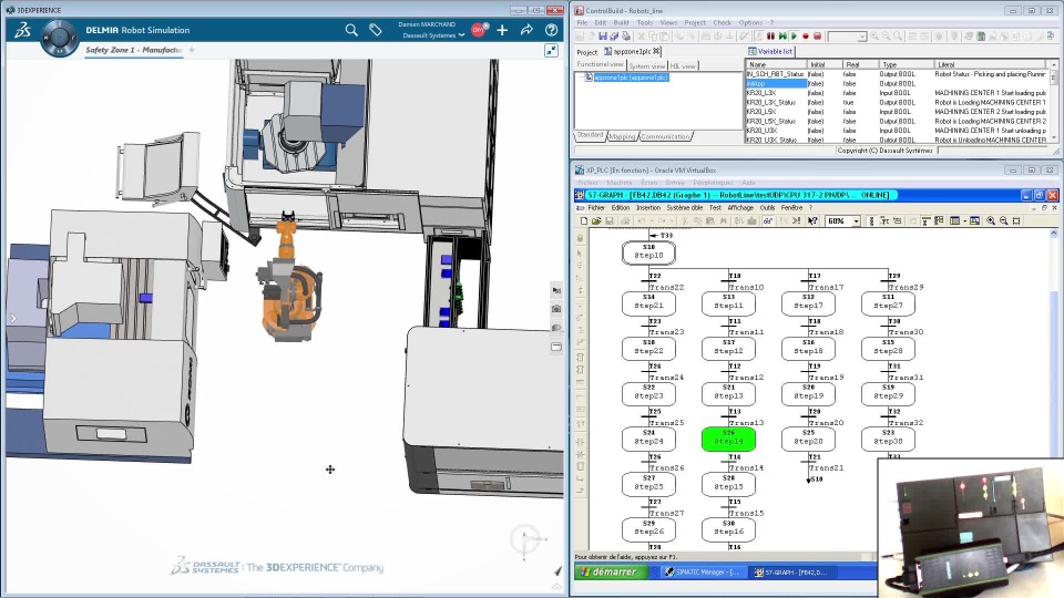

By keeping the same architecture, we can also perform virtual commissioning with real PLC (Programmable Logic controller). The purpose of this HIL configuration is to connect a virtual but realistic environment to the PLC, in order to debug more easily than if it was connected to the physical machine.
Indeed, the development of control software is always a very difficult course. The industrial commissioning of an automated system can even sometimes be dangerous in case of a bug. By coupling the functional simulation capabilities of ControlBuild with the power of the 3DExperience, we can provide a powerful solution to our customer. More and more clients ask us this kind of solution.
In this demo, we transferred the PLC code from ControlBuild to a Siemens PLC: the PLC pilots the robots as if the real one is connected. As Delmia can execute the real sequences of robots, we get a realistic environment. By this way, the control software engineers can perform a virtual commissioning in very good conditions, and after, realize the real commissioning on the physical plant with a high level of confidence.
