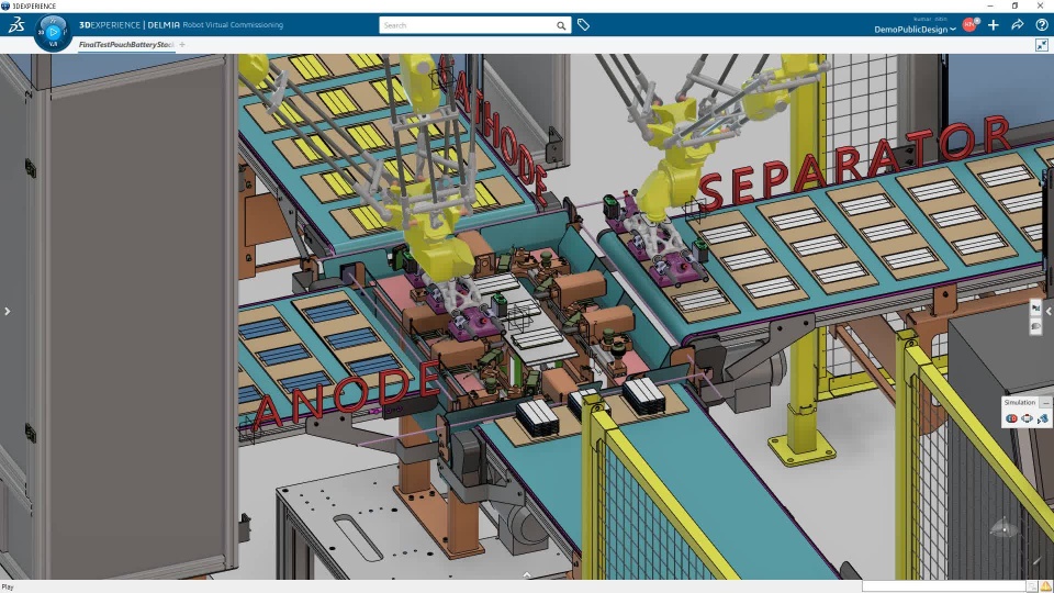

  1.  Define the Nominal Position of the Variable Tag
  2.  Create a Robot Motion to this Variable Tag
  3.  Define the Offset (Position / Orientation) on the desired direction(s), to automatically reposition the tag.
  4.  Create a loop simulation to reproduce the cycle: Move to Tag > Update Tag Position
Doing this, the number of Robot Program lines will be reduced, as your chance to make mistakes in your OLP !
To Highlight this new capability, have a look at this short demo video created for a Battery Stacking use case, using two FANUC Delta Robots. This demo will soonly be available in your Experience Center, as an official End to End T&M Demo.
