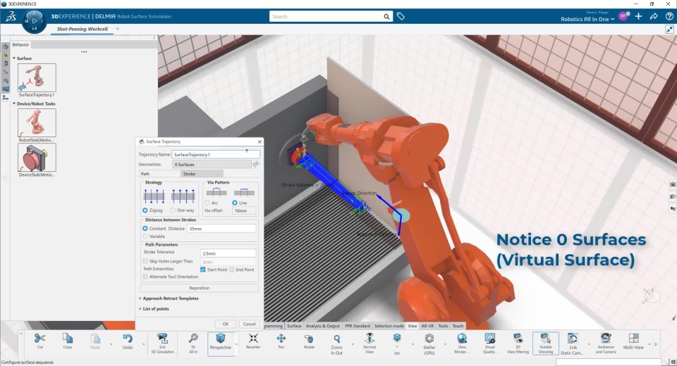

This short video will show the prerequisites required to run & visualize a shot peening simulation.
If the Surface Trajectory is created using
a. Virtual Surface - Manual creation of mesh on concerned part is needed
b. Geometries - Automatic creation of mesh at the start of simulation
