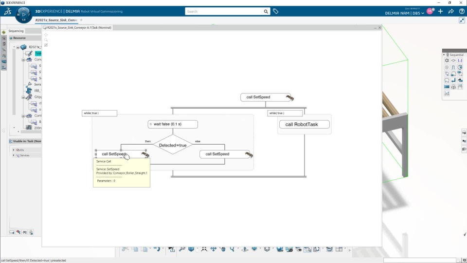

This video demonstrates the basic logic required for a robot to interact with parts being sourced on to a conveyor.
When a part is detected by the sensor on the conveyor, the robot receives a signal to pick up the part and place it in the sink.
The Source, Sink and Sensors are available in the R2021x FD08 DELMIA Robot Virtual Commissioning app
