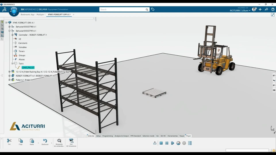

For this purpose, the Equipment Simulation Tool comes really in handy, as you can configure the Forklift as a "Robot", assign a few DOFs to it, and simulate a Load Task in a detailed way. As a kinematic mechanism always needs to have a fixed object, you'll have to include the ground into the robot tree and fix it, so that you can jog the forklift with regards to it.
See attached a short video showing this idea (be patient when loading the simulation task, as it takes a few seconds in the video), and the 3dxml model too, just in case this is useful for someone else (be aware that this approach can also be applied to many other industrial resources moving along your layout).
Kindest regards
PS1.- In this example the right Fork has a non-command prismatic kinematics, and a Kinematics relation (-DOF) with the left Fork, so that they can open or close as a gripper.
PS2.- The semaphores in the Teach Panel are showing yellow, as for this simple example I did not define travel limits (but default ones of 1000mm were applied), so the movements are supposed to be out of reach for the robot.
