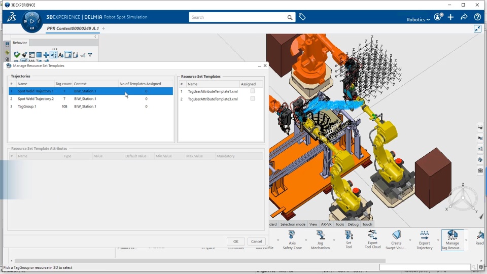

In R2021xFD06, a suite of tools is provided to easily create Tag User Attributes using Templates. The xml templates are saved in the 3DEXPERIENCE platform and can be applied to the Robot Trajectories. The User Attributes can also be imported into the 3DEXPERIENCE platform from V5.
  • Templates allow the programmer to quickly apply many attributes across a trajectory
  • The templates are xml based and assigned to the collaborative space

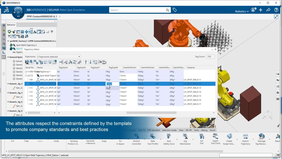

  • The Trajectory Editor provides a comprehensive view of all the attributes in a Trajectory
  • Tag Attributes can also be modified in the teach dialog
  • Attributes respect the constraints prescribed in the template
  • Modified attributes are color coded
