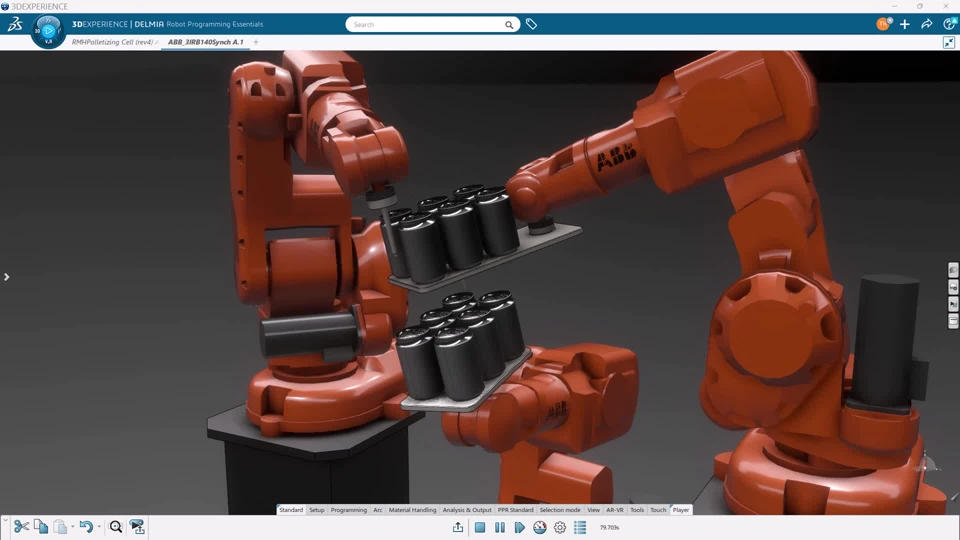

What’s New in R2025xFD01, DELMIA Robotics has the capability to simulate Synchronized, Coordinated, and Synch-Coordinated motions for robots and devices such as robots, positioners, and robot rails, across the virtual workcell, . What is also new is the ability to use the DELMIA Rapid Translator to upload and download to the production ABB robot using the native ABB Rapid MultiMove instructions.

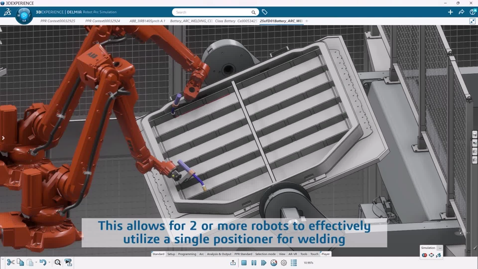

Sync-Coord - These motions are synchronized and coordinated. This can be used to have 2 robots (synchronized) while following a positioner (coordinated).
