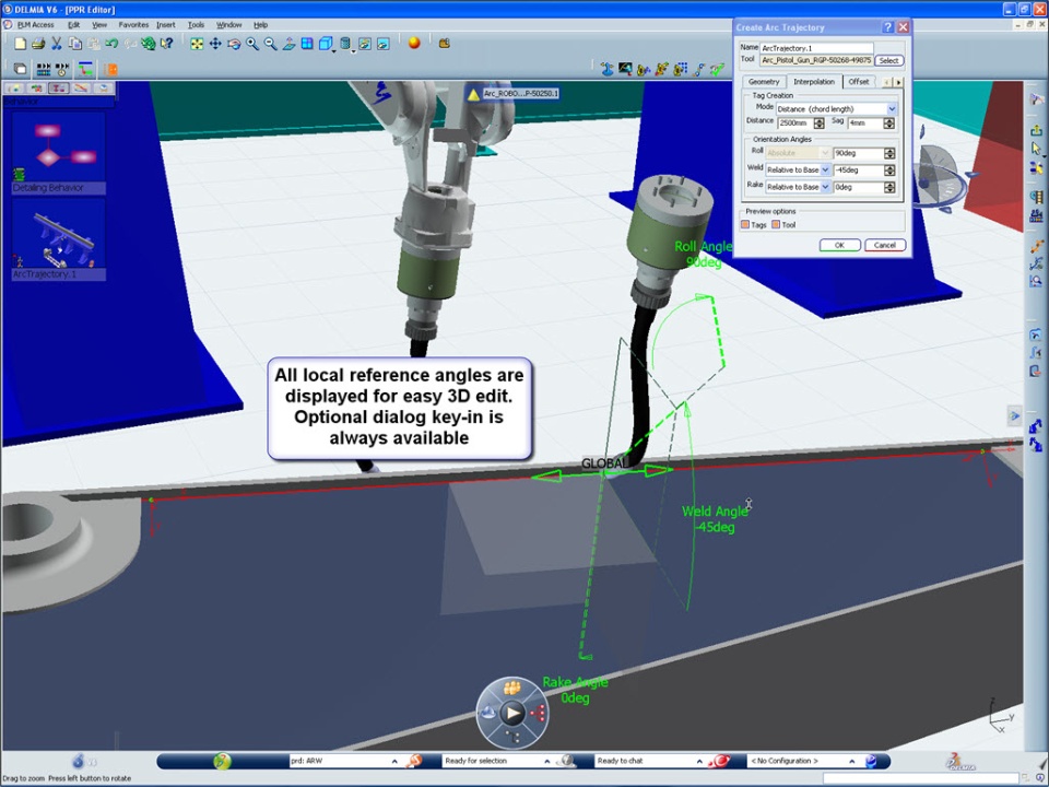

In addition, we've enhanced our Arc Welding applicaiton to make more visually obvious the different angles that the welding torch will use, plus the angles are interactive!  Just drag or click to edit.
