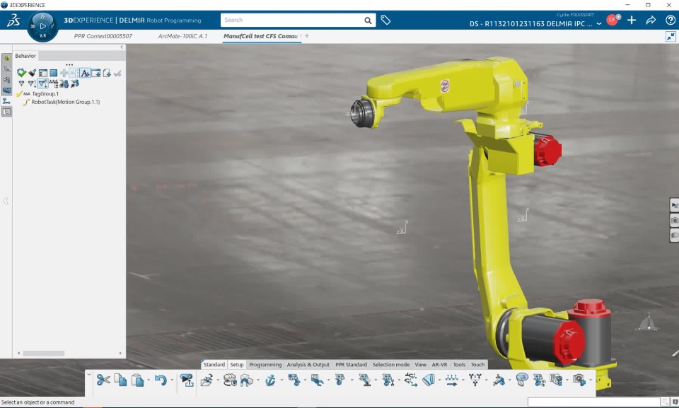

1. use the new commands available in 22x: export the Trajectory (Tags) in an Excel file, modify the position in Excel, reimport the Excel file to create a new Trajectory, and then use the "Compare and Transform" command to reconnect the old robottask to the new trajectory. This is the best method I think. Find attached a video showing this method.

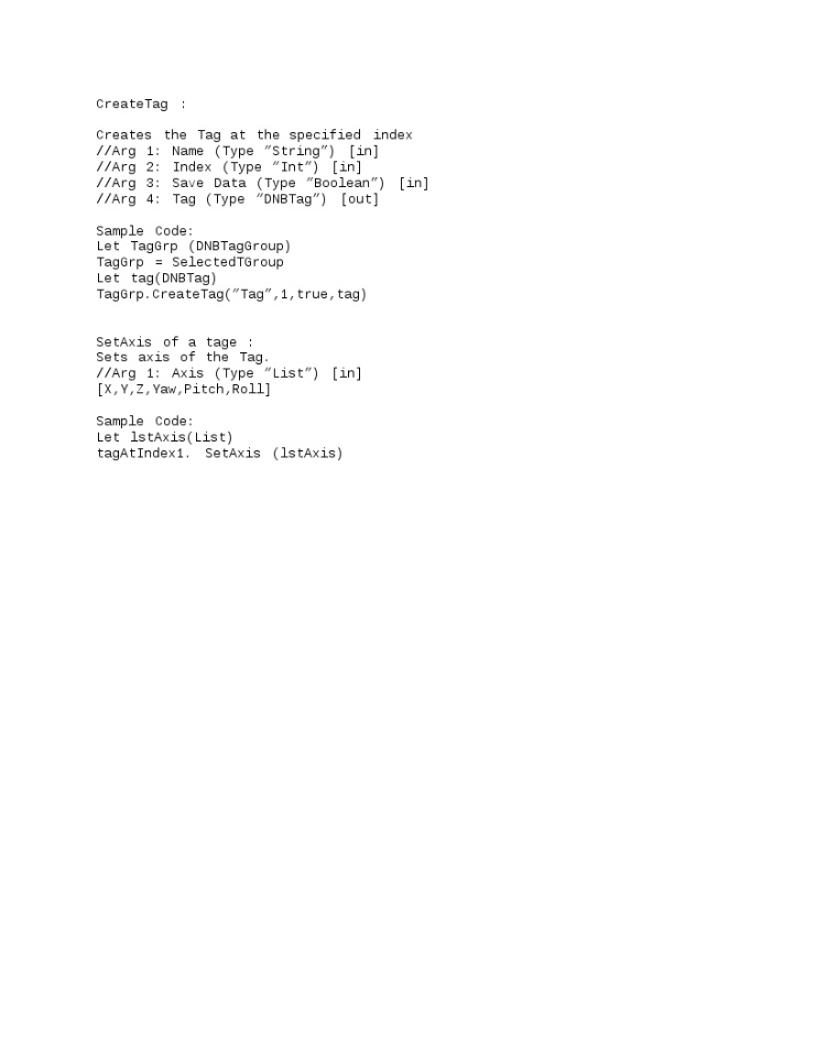

3. use an EKL macro to modify the Tags locations. Attached a small example on how to create Tags in an EKL Script.
