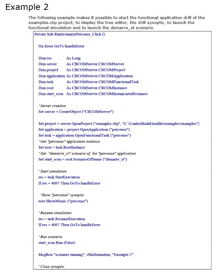

I am currently working on a Hello World test to read IO values from ControlBuild in a .NET project. When I read the "COM API Guide.pdf" there are two code examples, which are really good. The problem is that I cannot find its corresponding ControlBuild projects. Is there anyone that has these projects?
C:\\ControlBuild\\tooldir\\examples\\examples\\examples.cbp
