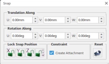

  • Snapping Resources from the Catalog browser in one click, just select the component to display a new snap panel
  • Available are translation and rotation offsets, where the user can input the distance and angle of the offset and it's direction.
  • Users can also lock the snap position of the resource along X,Y,Z, U,V,W.
  • Activate Snap by Connector Port function that allows the user to Snap a Resource by it's Connector Port.
  • Attachment possible can be done directly from the snap command panel.
  • The immersive panel now provide the ability to toggle between Local and Global modes when snapping.

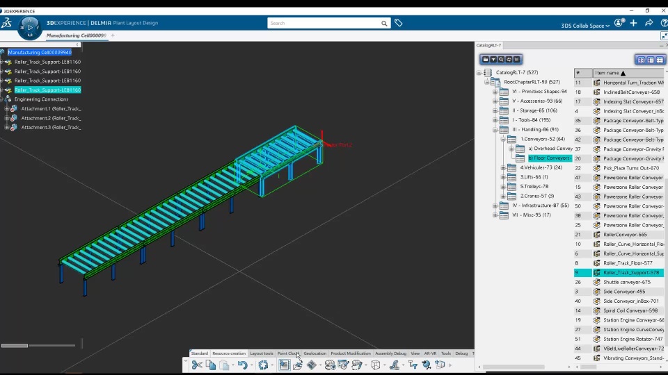

Take 2 minutes of your time to discover that in this video.
