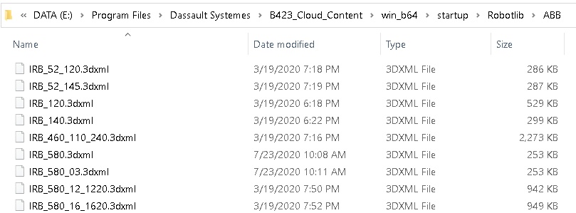

Individual Robots are now in Robotlib
When the Content folder is downloaded, (which is now optional during installation), the user will now find that the robots are available individually as a separate 3DXML file. This means that the entire robot family no longer needs to be loaded into your Database. The default location of the Robotlib is: ../Program Files\\Dassault Systemes\\B423_Cloud_Content (or B423 content)\\win_b64\\startup\\Robotlib\\.
This new organization is starting in R2021xFD02 On-Cloud, For on-Premise this is available starting in R2020xFD03 and R2021xFD01
