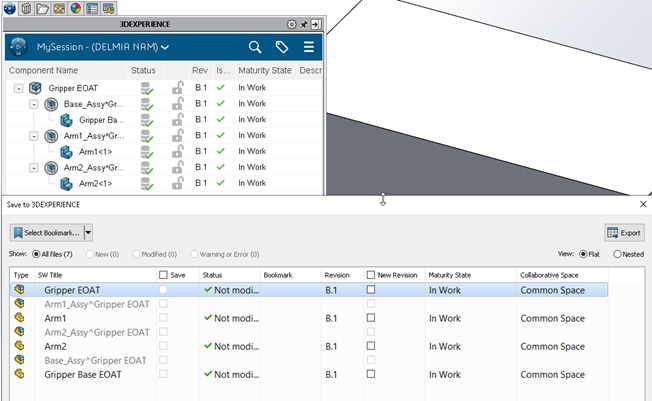

When you have 3D data created or imported in SOLIDWORKS, of course you can save it to a file. If you are also using a 3DEXPERIENCE Works product, such as Robot Programmer (RBS), and its application Robot Programming Essentials, you have additional functionality that can save the 3D data from SOLIDWORKS onto the 3DEXPERIENCE platform called PowerBy. When using this method, it comes along with certain rules in order to provide the proper level of digital continuity between the CAD Creator or CAD Master, and the manufacturing user in Robot Programming Essentials in (RBS). PowerBy provides for the versioning of 3D data as well as the history and vaulting of the data. When the design data is saved from SOLIDWORKS to the 3DEXPERIENCE platform using PowerBy (seen below), part of the CAD data cannot be modified in RBS. That is because the RBS user is not the CAD Master of the 3D data. This restriction ensures that the design part is not compromised by being modified by a user outside of the design workflow, and the outside user cannot break any of the inherent links to the CAD data implemented by the PowerBy functionality.
Saving onto the 3DEXPERIENCE platform from SOLIDWORKS using PowerBy

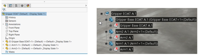

This can introduce some challenges into the workflow when using RBS. Particularly when the RBS user wants to create data that would be interjected into the CAD file structure, such as when creating kinematics. When kinematics are created in RBS, this functionality will attempt to insert coordinate systems into the 3D data set. If only the part level is present, there will be difficulty. If an attempt is made to insert the coordinate systems into a node that cannot be modified (such as a part node saved from SOLIDWORKS using PowerBy), then the kinematics function will abort prematurely and complain about an attempt to modify PowerBy data. Since the RBS user is not the CAD Master, they do not have the credentials to modify the part, thus kinematics will not be added or saved.

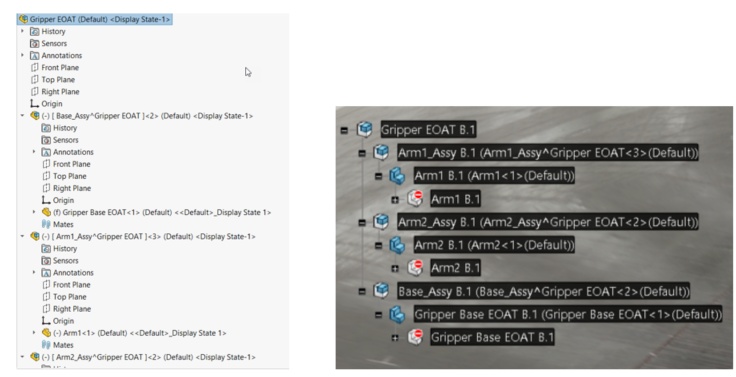

Organizing SOLIDWORKS data in a flat structure
One way to side-step this permissions dilemma is to change the construct of the CAD tree in SOLIDWORKS by making sure that every part has a parent assembly. This way it is possible to create elements in SOLIDWORKS so that the Axis Systems are created under an assembly node, instead of a part node where the 3D shapes contain a 3D body that cannot be modified. This simple adjustment to the CAD structure allows for kinematics to be created. This is because the Assembly node can own the new coordinate system without violating any permissions imposed on the CAD Part by the PowerBy function.
Organizing SOLIDWORKS data using Assembly nodes

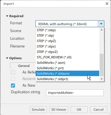

As with all things, there is more than one way to save and import data into Robot Programming Essentials and the 3DEXPERIENCE platform. If the user is creating resources with kinematics, and that design data will not be updated or modified during the project timeline, then the user may choose to save the 3D data from SOLIDWORKS to a file (SOLIDWORKS part or assembly), and then use the Import function in RBS to import the file onto the 3DEXPERIENCE platform. This method will allow the Robot Programming Essentials user to modify the CAD data by allowing kinematics to be applied to the imported data without restriction. However be aware that this method sacrifices the update to latest revision function, as well as the robot path update functionality.
Importing SOLIDWORKS files into the 3DEXPERIENCE platform using Robot Programming Essentials

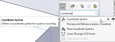

Finally, there is one other way the user may want to apply kinematics to a resource or product design. In this case the design will be periodically updated during the project process. This method will use the SOLIDWORKS model and create coordinate systems needed for each degree of freedom in SOLIDWORKS. These coordinate systems will then appear when the 3D design is opened on the 3DEXPERIENCE platform. The Robot Programming Essentials user will then create the kinematics using the coordinate systems that were created inside SOLIDWORKS. This method will retain any update to latest revision capabilities and will also allow the user to update the robot paths with the new revision as the links to the CAD Master remain intact. This method requires that the SOLIDWORKS designer has some knowledge about what is required by RBS to create kinematics, but with a little collaboration and understanding it is a success.
Creating coordinate systems in SOLIDWORKDS to use for adding kinematics
