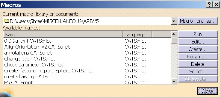

You can create a macros (Go under Tools/Macro) or type ALTF8 You will get the following panel.

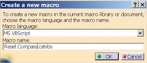

Click Create and enter the name you want and Click OK in the dialog as below.

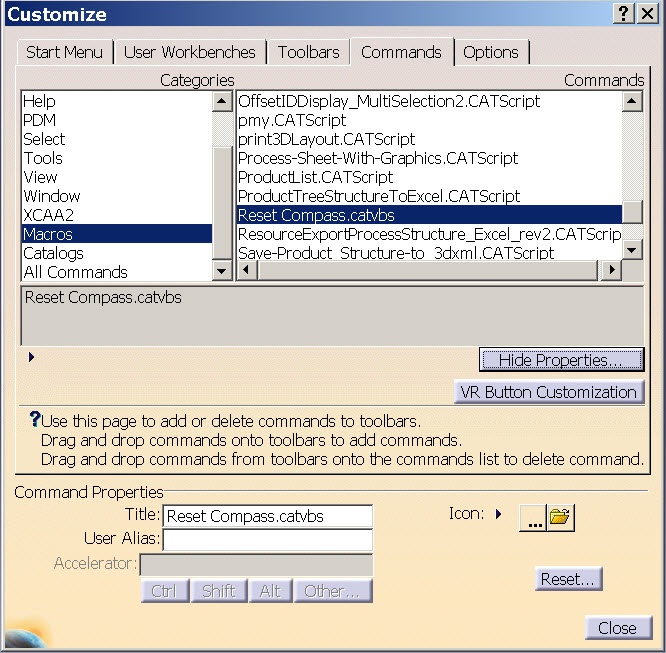

You can then create a shortcut  by using Tools/Customize, You will get the following panel
Select the Commands tab, select Macros,  select Reset compas.catvbs
Click on Show Properties and Enter the shortcut OR select the Icon you want and If it's an Icon, you can then drag it inside any toolbar in V5.
