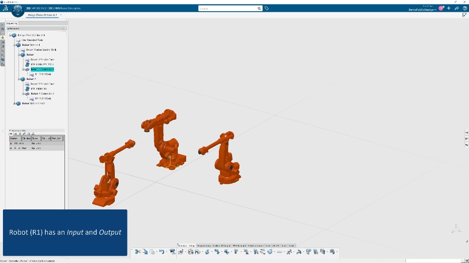

A robot station is defined as a Manufacturing Cell. If the robots in the station are siblings, then it is simple to define and map inputs and outputs between the robots so that the robots in the station can communicate with each other.
If the robots in the station are not siblings, but each robot in the station is contained in their own Manufacturing Cell, then defining and mapping inputs and outputs becomes more complex.
This video demonstrates how to:
- Daisy chain inputs and outputs between a linear series of Manufacturing Cells
- Define and map robots in a station where each robot is contained in their own Manufacturing Cell
