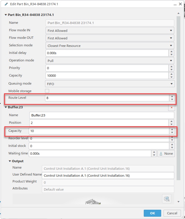

In my example,
My buffer Capacity is 10 and my route level is 8
You will notice in the simulation the buffer will stack up till it reaches a capacity of 80% and then the AGV is called.
The AGV has picked up its first product and you will notice there are 7 quantities in the buffer.
