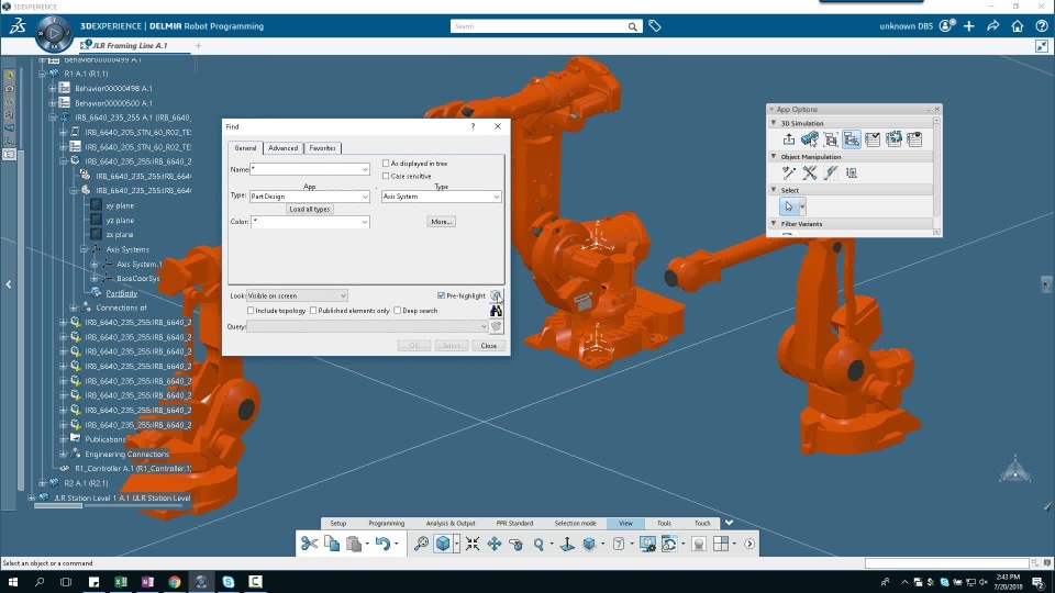

When building a robot station, often product data comes in with all the axes systems in a shown state making it very difficult to determine between these axes systems and tags that have been defined as robot targets. If you use the View => Customize View =>No axes command, all the axes systems will be hidden, but this functionality also hides all the tag targets. You can search for only the axes systems and hide them altogether, without hiding the tag targets. The attached video demonstrates how you can achieve this.
