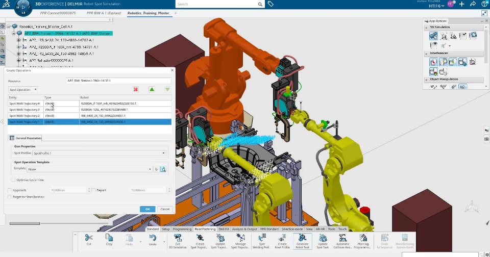

Generate Robot Tasks for Multiple Robots in 1-click
A large majority of robot applications consist in performing Spot or Rivet Tasks on multiple cells. This process often presents a multi-robot aspect.
To generate a robot task, we could select between one Task/Industrial Robot only; this process can present many clicks when having multiple robots.
From DELMIA R2022x FD04 (FP.2232), the command is enhanced to also allow for the selection of a Manufacturing Cell. The "Generate Robot Task" now allows generating robot tasks (from Spot/Rivet trajectories) for all robots in the same manufacturing Cell in one click. All the created Robot Tasks will have the same name as the corresponding trajectory when selecting the Manufacturing Cell.
Here is a short video showing an example of generating 4 robot tasks (from spot trajectories) in one click:
