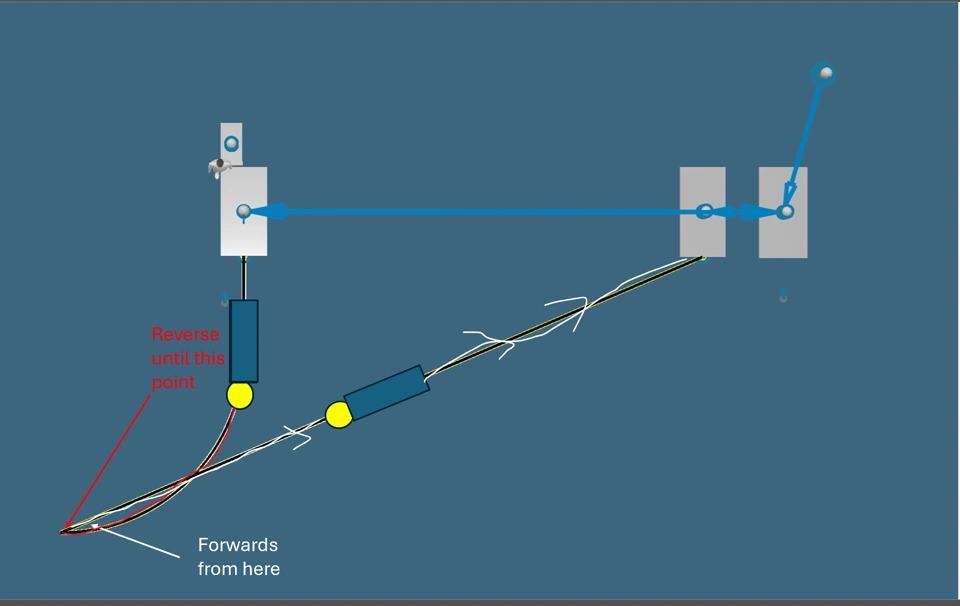

I'm trying to simulate the movements of tools and if there is enough space to safely move tools from work center to work center.
The tools require human movement, so I believe I need to model them as a mobile storage to allow me to constrain their movement by human resource availability.
A pathway I'm trying to simulate is "pulling out" from a work center, the same you way you might reverse out of a car park and then drive away.
I'm struggling to achieve this behaviour as I don't know if there's a way to change the product position relative to the worker based on a time/ event in the simulation.

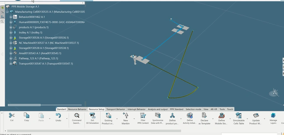

Additonally, I'm struggling to get the "Define Product position with worker" to work. (Seems no matter how i modify the trolley, it's in the same position in the simulation).
Any assistance or best practices when it comes to evalulating tool movement is appreciated.
