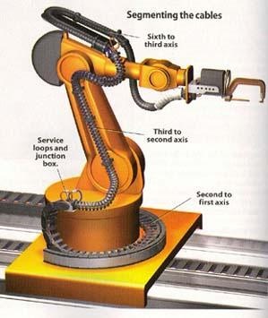

** In case of six-axis robots, cable design can be divided into three separate segments: the sixth to third axis; the third to second axis; and the second to first axis.
From the sixth to third axis:
  • Use strain-relief cables on the moving end (sixth axis) with a one- to two-foot service loop.
  • Protect cables and hoses with a modular, multi-axis cable carrier.
  • Segment cables at the third axis and install a junction box for quick diagnostics and cable replacement.
From the third to second axis:
  • Use strain-relief cables on the third axis with a one to two-foot service loop.
  • Use a modular, multi-axis cable carrier.
  • Segment cables and install a junction box at the second axis.
Finally, from second to first axis:
  • Strain-relief cables on the second axis with a one to two foot service loop.
  • Install a multi-axis, reverse-bend cable carrier to protect and guide cables and hoses rotating around the robot.
  • Segment cables and install a junction box at the first axis.
Segmenting the dress pack into three shorter sections prevents it from wrapping, catching, or snagging on machines, and minimizes stress on cables and hoses. This approach applies to any six-axis robot, regardless of manufacturer or application. While other fixes, such as duct tape and ties wraps, might work temporarily and cost less, in the long run properly designed dress packs reduce unnecessary downtime and maintenance costs.
