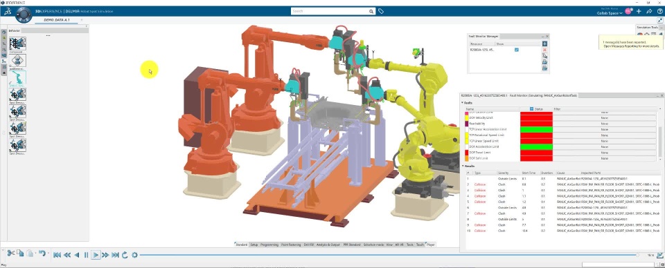

(DELMIA Robotics) Fault Monitor Highlight in 20xGA
In previous release, to find collisions in Robot Simulation we had to define a probe and in the scenario use this Robot task with Probe to list collisions. This was time consuming and not user friendly.
Since 20X GA , we have a new functionality ( thanks to R+D team) – Fault Monitor

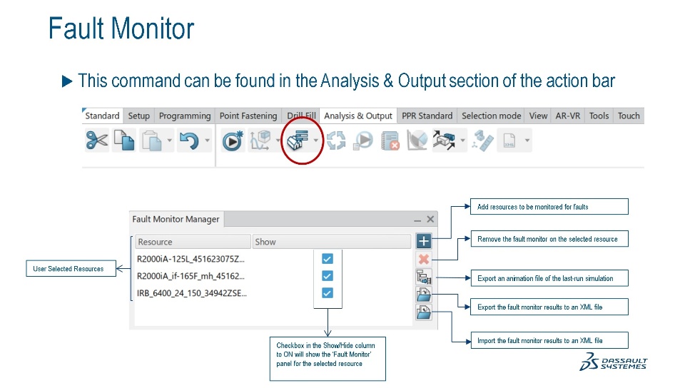

Users now will be able to :

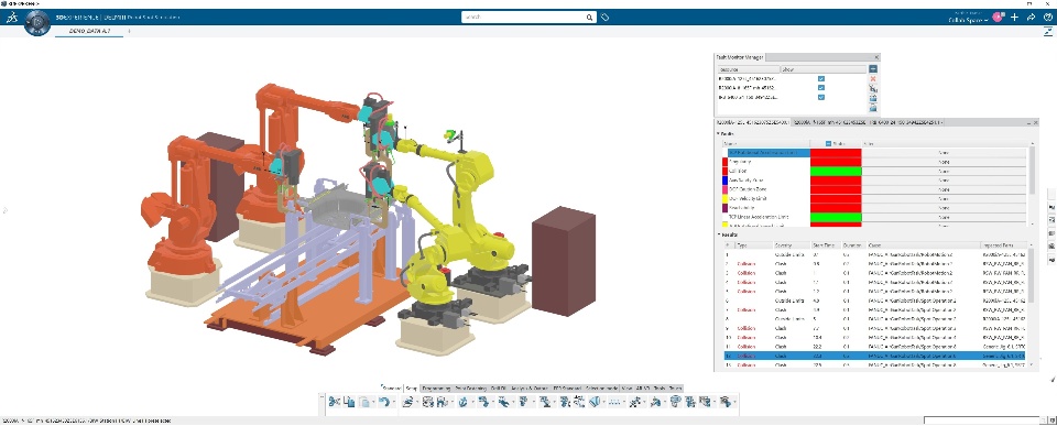

  • Monitor all the issues/faults (collision, over-travel, speed/acceleration limits etc.) related to a resource that occur during a simulation run
  • Diagnose and detect the issues causing the fault ( Narrow down to issue quickly)
  • Record simulation log files in xml  detailing all the faults that occurred during  sim run
This function will allow users to define a fault monitor on a specific resource.
Then track this resource for any faults that may occur during a simulation run and display fault information that occurred at various times during the simulation.
Users can jump to the time when a specific fault was detected and investigate the cause(s) of the fault and resolve any issues.
Finally, users can export the detected faults to an external file.

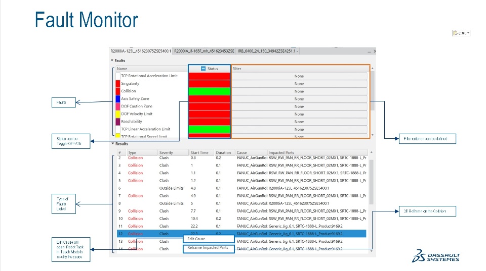

Command explained :
Using the contextual menu on each fault result ,user can either re-frame on the issue to narrow down the problem area or "edit Cause",which will open the Robot task in Teach Mode.
Note : Users may see a performance impact when running a simulation with fault monitoring turned on depending on number of fault monitiring resources selected ,each selected  resource will be analyzed for faults at each simulation step
