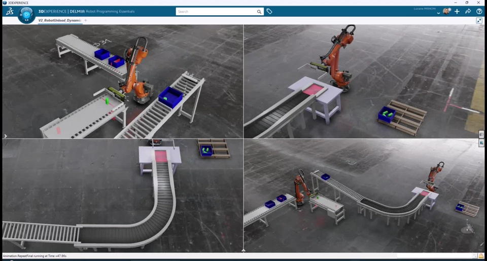

DELMIA Robotics- Conveyor Dynamics
Recently we were asked to demonstrate if our solution was able to simulate "Gravity" roller conveyors. To make it more complex they wanted us placing a bin on the conveyor, with a gate holding the bin in place while the robot fills the bin with parts. The gate was then to retract releasing the bin to go down the conveyor to another robot, this robot would then pick the filled bin and palletize it at the end of the line.
