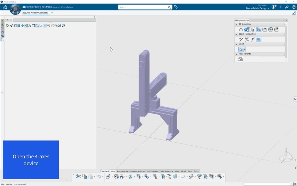

DELMIA Robot Virtual Commissioning - Create and Trigger a Boolean Signal Based on the Joint Value of an Actuator
The example scenario shown in this video demonstrates how to create and trigger a boolean signal based on the joint value of an actuator. This can be used to emulate a sensor that monitors the open and closed positions of a pneumatic clamp (or multiple clamps on a fixture).
