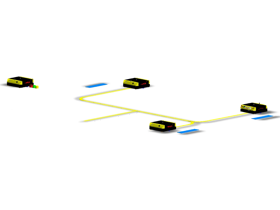

I have a kinda one-line setup of 3 AGVs delivering 3 products to a drop-off zone. I wish for the 3 AGVs to run sequential. To do this i am using traffic management. The two AGVs to the right in below image are in the same resource pool, meaning if one is deactivated the other can pickup both parts on the right side. My issue is:

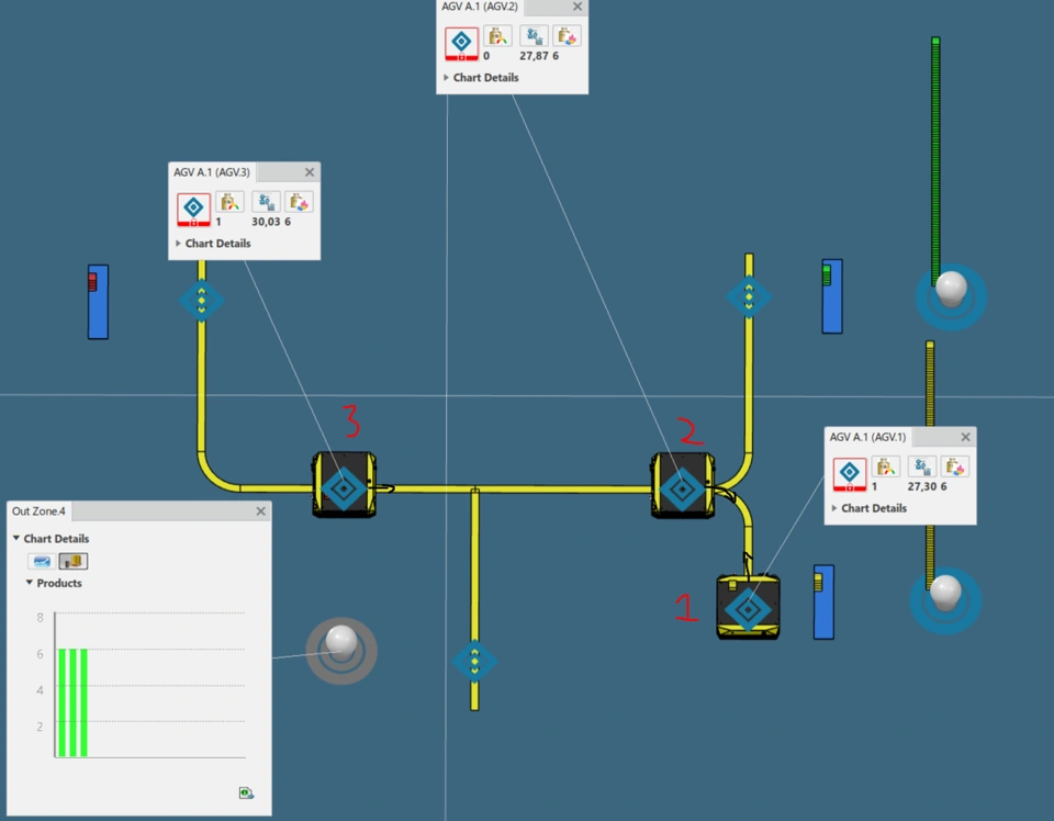

  1. After perfectly delivering 6 parts each, the AGVs on the right block eachother causing everything to get blocked. This is due to the fact that AGV2 is trying to go AGV1s pickup, but ofcourse AGV1 is there waiting for a clear path, see second image.
How do i get it such that AGV2 always goes to the free pickup zone? I have tried using "closest free" and many other settings, but i cannot get it to function as intended. Anyone having experienced a similar issue?
