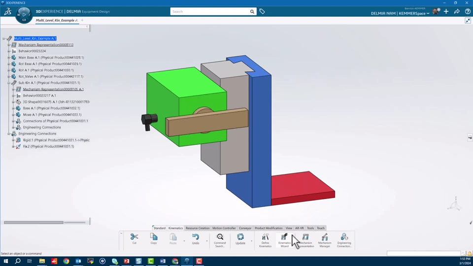

Customer is using non 3DX CAD for tooling design. Need to not be required to re-structure the tooling structure while still applying kinematics between multiple levels. This ensures the cleanest way of ensuring Digital Continuity and future updates due to tooling design changes. See video for additional details.
Methods Employed
Usage of a combination of both OOTB DELMIA kinematics definition as well as Engineering Connections in order to properly define kinematics while not disrupting CAD/Tooling structure.
