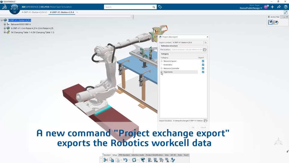

This issue is now solved by introducing 2 new features to export and import all robotic information not included in a 3DXML with compatibility mode.
Information supported in the export/import project: Simulation state, kinematics, attachment, robot tasks, resource controller. Logics will come soon.

And I let you watch this short video to explain how its works.
