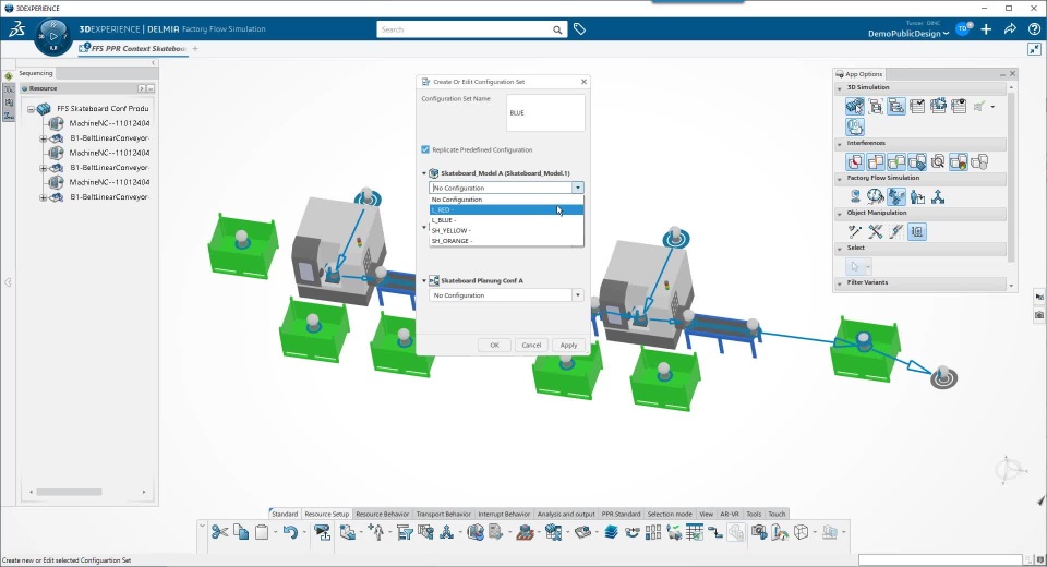

Hello,
finally, I managed to create a simple example for using a configuration in Factory Flow Simulation. Unfortunately we don't have that many, so I found it useful to create one.I built the example of the well-known Skateboard in 22X.
The video shows how the filter can be applied to the different variants in the planning.
This can easily be applied in Factory Flow Simulation as a configuration set. The production program at the resources then controls the order in which the different variants are to be produced via the Excel spreadsheet.
If you have any questions, please give me a short feedback.
