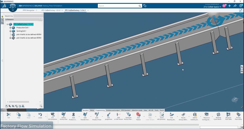

You can create a factory flow between several resources such as conveyor, NC machines, and storage resources. 2 Methods are available to generate a factory flow :
  • 1st method: automatic creation of factory flow by clicking the resources along the line (from InZone to OutZone) shown in this video.
  • 2nd method: manual creation of factory flow using the “resource configuration” command.
