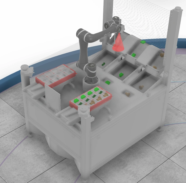

I'm pleased to explain the Robotics demo we prepared for the Hannover Messe this year.
We presented our "New demonstrator of flexible manufacturing line".
Flexibility, this is an important work we can hear more and more ! But what about Flexibility in Robot Programming ?
The use case we show is a good example of the need to bring flexibility to assembly lines:
The Robot has to take part on the Storage, but:
The Pallet may not be always oriented the same, so the filling order will change
The parts may not be located always at the same storage position, so the picking position will change
The parts & pallets may no be exactly at the exact position than the nominal one used for Programming, so offsets can be generated for both pick & Drop Positions

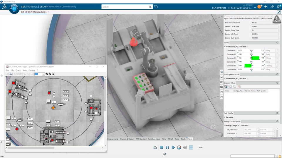

In the Following video, you will have an overview of:
How we can use Position Variables to bring Flexibility when Teaching the Robot
How you can monitor some metrics of the Simulation (IO Activation, Cycle Time, Robot Jog Values...)
How to have an overview of the Power and Energy Consumption for one / several Robot Cycles (and how to make a trade-off between Robot Cycle Time and Energy Consumed, reducing Robot Speed or Acceleration..)
And the most important part, is that on top of Simulation and Validation, you can then Export the created program using our provided translators!
