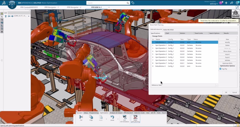

Both aspects are addressed thanks to our "Robot Path Planning" feature available in the Robot Optimization APP [ROS]. This feature can optimize the robot's task while avoiding collisions automatically.
Here is a video showing how this feature can automatically solve collisions and configuration changes!
The video shows a step-by-step scenario where the initial Robot Task presents many collisions and configuration changes. Thanks to the "Path Path Planning" feature, the new calculated robot task solution removes unnecessary robot configuration changes. It adds via-points to avoid collisions even in a constrained environment (last robot spot operation).
