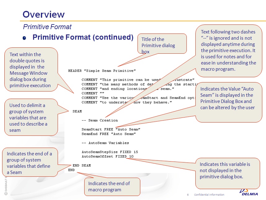

END - Designates the end of the template file.  See Attached image for an annotated example of a basic Primitive file.
